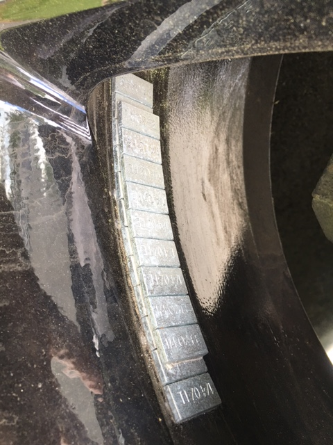

So I was getting in my truck yesterday, and something caught my eye in the front driver rim. I check it out and look how much weight they put on it,I've never seen this much, its insane. They f*cking doubled it up on the same spot.
Jesse, any vibration issues? lol
FFS, you had it for the last repair attempt and the GM jackasses do that - they aren't even trying.
hahaha I know right. I will say the vibration is greatly reduced, still felt slightly, gets worse when on incline or declines and going around corners. The critical points of the vibration have changed too, the speeds dropped from 74 - 78 to 70-76 and 46 to 43. The change of the tires and weighting changed the critical speeds... but that weighting is just absurd. I'm going to go to some repair and tire shops and see if I can get a letter saying that it is beyond what is reasonable and use that in arbitration as well.
gets worse when on incline or declines and going around corners - These are the same symptoms I have.

I just got back from a Mechanic near my house, 2 tire shops, and a performance shop. I discussed this all with them, and showed them the 5 &1/4 oz of weight. All of them agreed that that much weight on one spot is way too much. I told them that I have also tested my 18" rims & tires and still have a vibration with them on. All 4 shops based on that said they think it it is in the drivetrain specifically referring to the axles, drive shaft, hubs or it could possibly in the suspension. Regardless that kind of weight is just masking the issue, and would mean that everytime i get an oil change and have teh tires rotated, they would have to perfectly rebalanced to continue to mask the real issue. 2 shops recommended that I rotate the front and rear rims to test the theory. If the vibration stays reduced it could be a bad rim (unlikely) if not the weight just masks the real problem. I have also set up an appointment to have the rims and tires checked at a shop that I trust, I'm not going to have them rebalanced there because I dont want it to screw anything up for arbitration, but I am going to get them checked.
Wow !!!!
I'm speechless and that says a lot lol.
