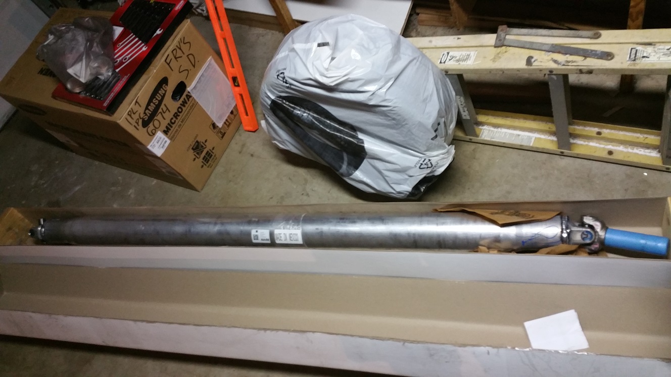

Ok guys, reporting back as promised. Drive shaft went on with no problems. It came with new Ujoints and yoke to slide in. So very easy to install as it came all in one piece...I don't want to jump the gun here because I only drove down a back road but I hit 70mph. USUALLY the second I hit 60mph I start to vibrate and it stays steady unless I push out to 70-80 and its much less at that speed. Well...it was GONE! I was screaming for joy in my truck when I hit 60-70 and no vibration!! Like I said...I still need to get on the freeway and do more testing but the first test drive was a complete success!!! I will note that I also put on my Magnaflow exhaust (Which sounds amazing) so I don't know if that could have changed anything (highly doubt). I'll get back to you guys after I do more driving. Today was a good day!! (Ice Cube Voice)
