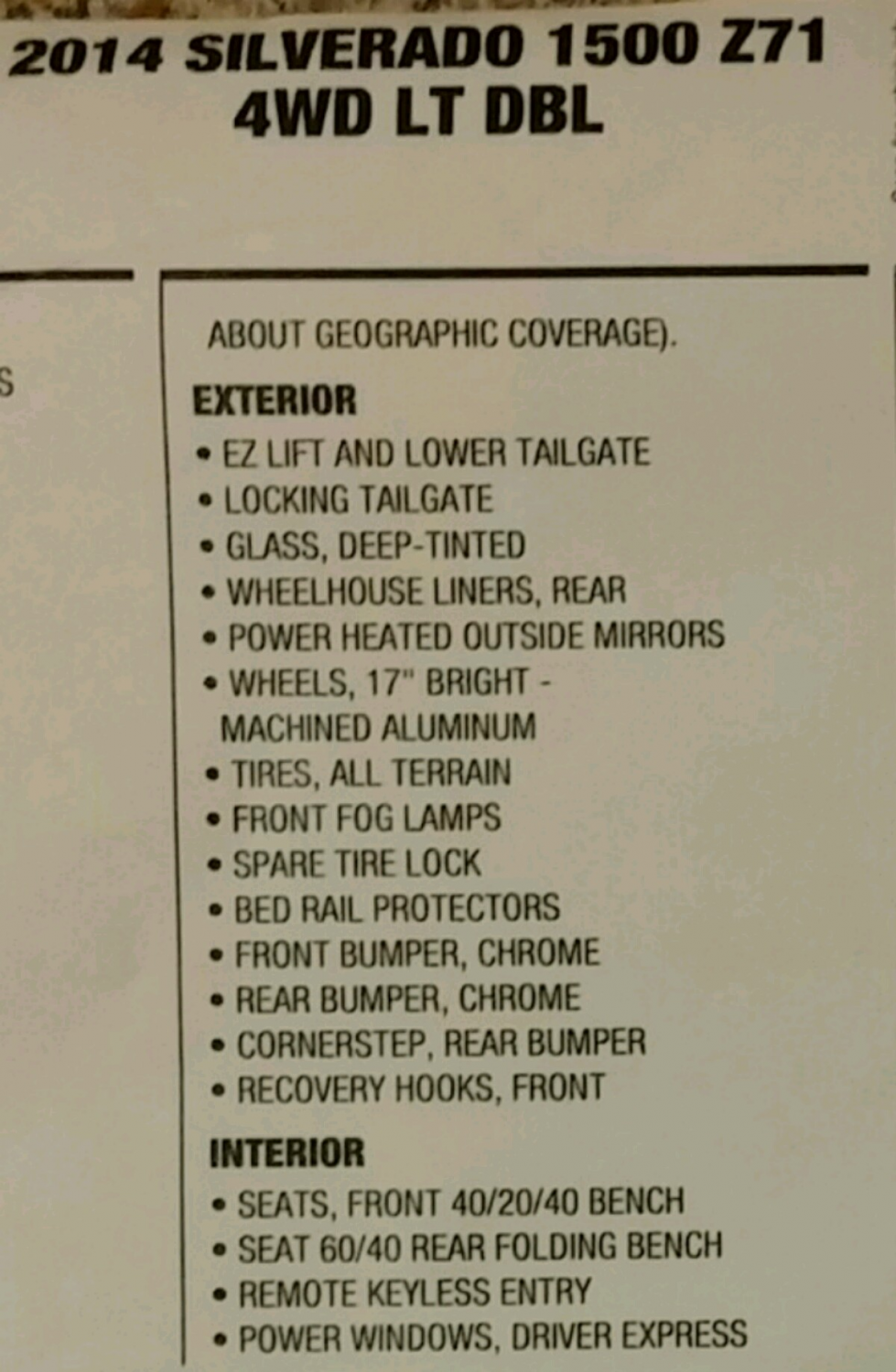

Well then GM owes me a set of Dueler A/Ts and they can take back these flawed SRAs. They definitely are not all terrain tires, and surely not an upgrade either. Right now I feel I have been ripped off for $200.
Can anyone else chime in if you ordered or have a truck with the $200 all-terrain tire option (code RC7)?
My truck's window sticker lists all terrain tires and it came with the Bridgestone Dueler A/Ts. I swapped em out for larger Toyo Open Country A/T II's though. But in any case I think you should have gotten the Bridgestones and not the GY's. I'd go talk to the dealership.
I have the goodyears on my truck too and they charged me $350! Must be more for those fancy white letters that no one likes!
tlake84 window sticker

The chat speaks for itself. If GM is going to sell customers an option for "all-terrain" tires, and are giving them cheap standard highway tires, there is something wrong there and customers are getting cheated.
Huh yeah i have the all terrain W.O.L. tires listed on my sticker but have the SRAs...... anyone have info on this?
I'm in a dispute with GM regarding this. Goodyear Wrangler SRA tires are not all-terrain tires. See my chat above with TireRack customer support. You can also search for all terrain tires on their website, and the Goodyear SRAs do not pop up as a choice for all-terrain.
JesseD mentioned that previously, trucks were being built with Bridgestone Dueler A/T RH-S tires, which are in fact actual all-terrain tires. They are also around $20-30 more per tire. A fair upgrade and at least you are getting something extra for your $200.
My theory is that GM has had such a cluster-bleep with the Goodyear SRA tires (it is a documented fact that large batches of these tires were produced out of spec, and are impossible to balance), and so many customers have complained, that GM is now throwing these tires on as many trucks as they can, so they can burn through them...and then stick Goodyear with a nice bill for all the defective tires.
Either that, or GM simply made a mistake and started building trucks with the all-terrain option, with non all terrain tires.
Either way, you should complain if you got SRAs and paid for all-terrain...because you got ripped off.
