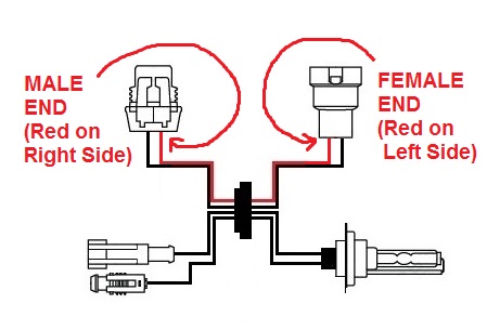

However, they did make a big "boo boo" on some of their bulb wiring extensions (the 6"-10" wire that comes with each bulb that include male and female plugs on opposite ends). On some they may have actually crossed the connection from one end to another. Not a huge problem, just something you should check before beginning installation. See attached diagram for the correct way they should look. If reversed, not a problem.. just means you'll need to flip that connection for normal install (dual input) or leave as is if your install requires a flipped connection (single input).
