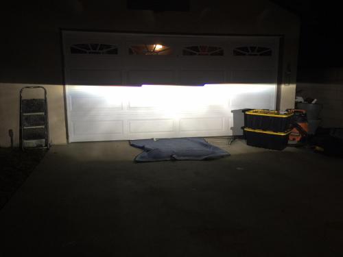

So I just finished my projector retrofit on my 14' Sierra. FXR 3.0, 55W 5000K Morimoto setup from TRS. I used the "rear entry" method that was pioneered by Bass Mechanic, I think. It went pretty well. Taking apart the front end of my truck kinda sucked. The first light took about 4 hours and was pretty stressful , the second took about 1.5hrs. Very happy with the results. The harness that they sold me had the stock input inverted( black to red, red to black). I got a loud relay buzz on my test before install. I swapped the stock input plug( red to red, black to black) and that fixed it. Thanks to all the people on here for the info to do this on my own (First DIY retrofit).post-135731-0-36748200-1414551527_thumb.jpg
So I just finished my projector retrofit on my 14' Sierra. FXR 3.0, 55W 5000K Morimoto setup from TRS. I used the "rear entry" method that was pioneered by Bass Mechanic, I think. It went pretty well. Taking apart the front end of my truck kinda sucked. The first light took about 4 hours and was pretty stressful , the second took about 1.5hrs. Very happy with the results. The harness that they sold me had the stock input inverted( black to red, red to black). I got a loud relay buzz on my test before install. I swapped the stock input plug( red to red, black to black) and that fixed it. Thanks to all the people on here for the info to do this on my own (First DIY retrofit).attachicon.gifIMG_1907-1.JPG
How do those 55W 5000K bulbs match your factory DRLs? I'm looking to either retrofit or get mine retrofitted soon. I want to do it myself but don't want to screw them up
I'm looking at ordered the parts and getting the shop to install everything. Will save me a few bucks that way. I could save more if I do it myself. How difficult was it for your first DIY retrofit?
I'd say the color match is very good, I can't see a differance from the DRL's. I originally was going to have a shop near me do the work but after a few minutes of explaining to them how to do this retrofit I lost all confidence in them, and they wanted $400 for the labor just for the headlight mod. I still had to get the lights out, back in , and wire it all up.
The hardest part or the retrofit, in my opinion, was keeping debris out of the housing. I learned fast that taping up everything was the way to go. If you are patient and have good jimmy-rigging skills, I'd go for it.
