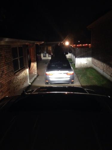

Hey so you guys that don't have the retrofit projectors, can yall post some pics so we can see the light output with the HID conversion? Seen plenty of pictures in the thread from retrofit, but not many from the stock projectors.

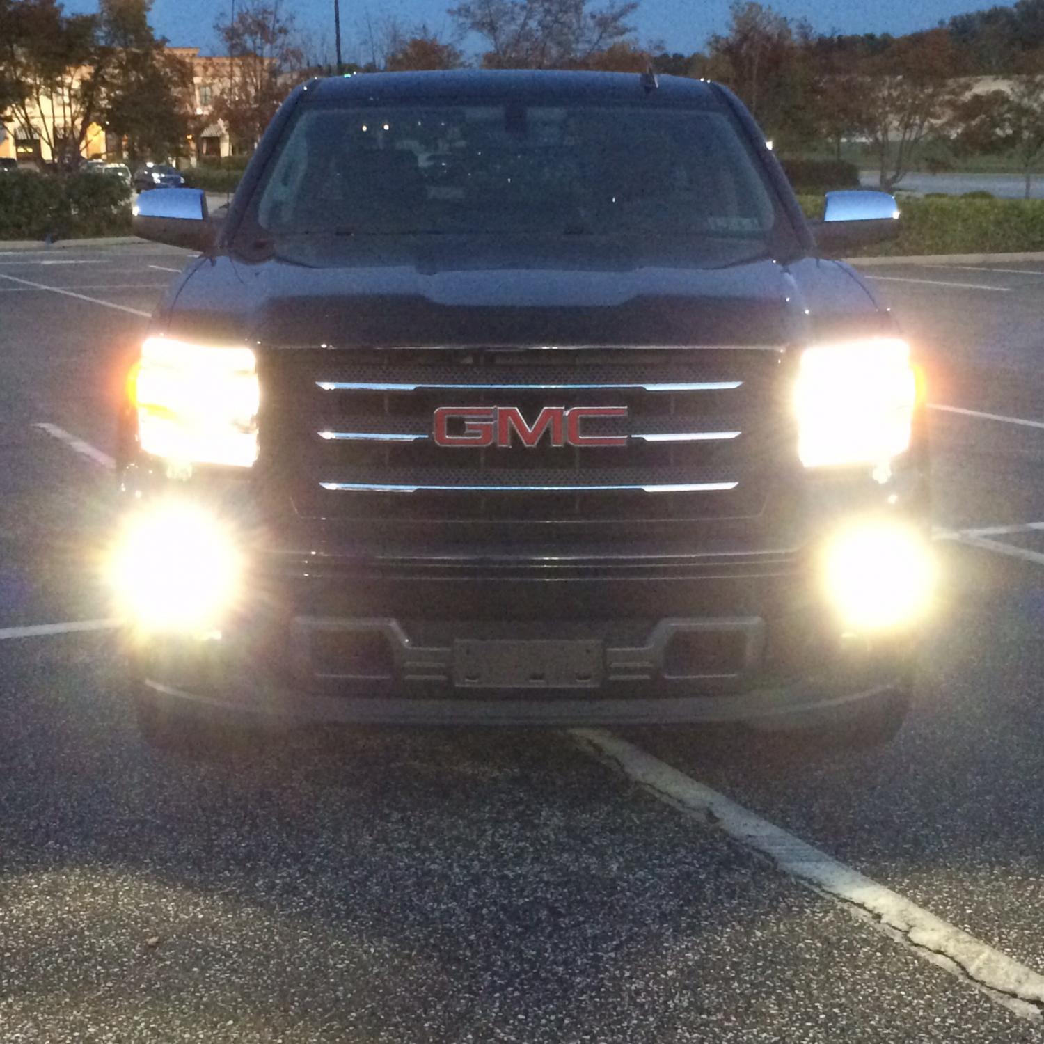

Stock projectors, 55W 5000K from DDMtuning
These are from the night I installed them

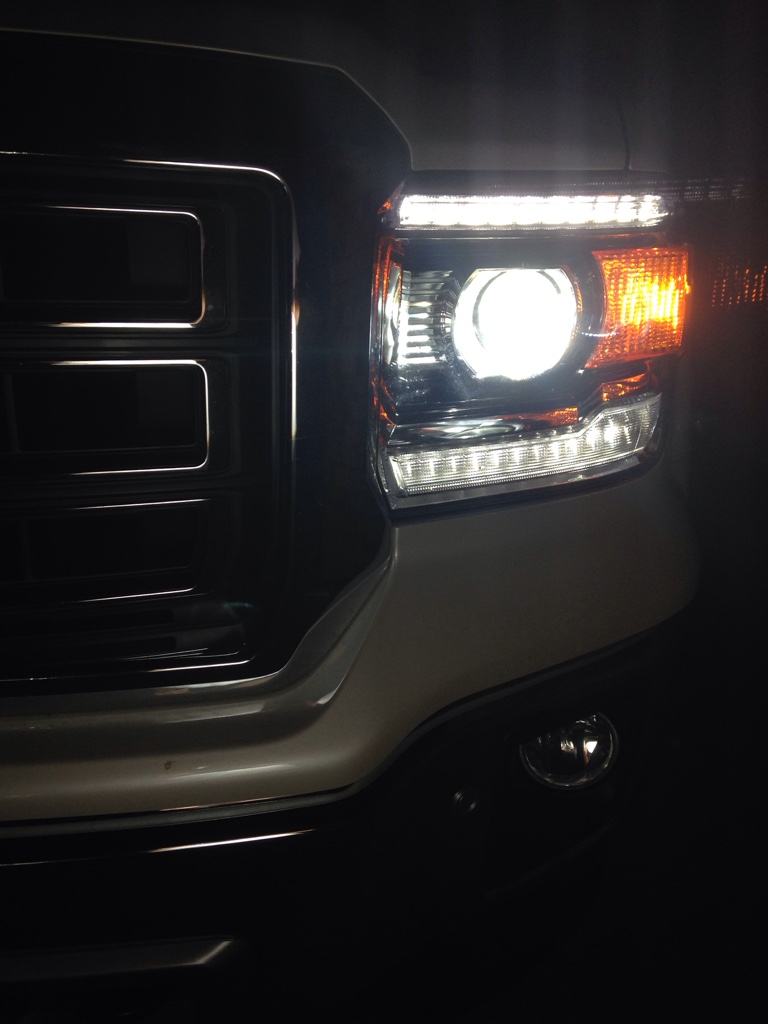

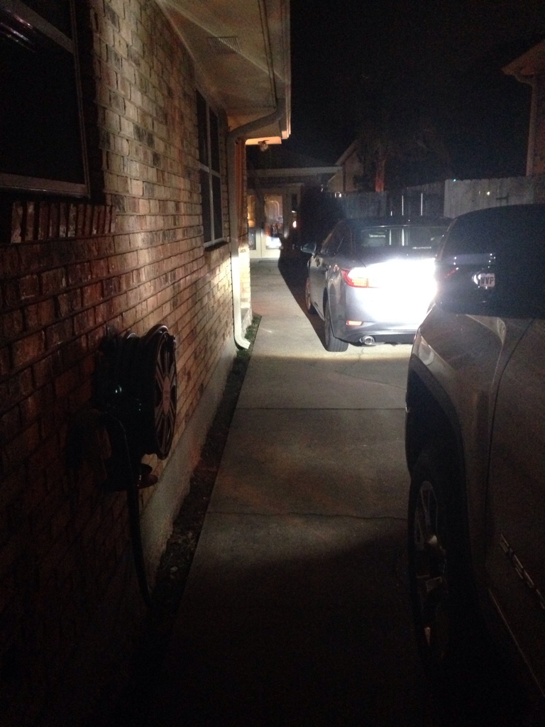

Low beams with 35w Morimoto kit in OEM projectors
the problem with this request is unless you actually drive with this mod the initial pictures you see don't tell the whole story.
unless you can see the beam pattern and the light and dark spots while moving which are hard to see from a picture the pics posted are very misleading.
trust me, if I could have got an acceptable beam pattern with the oe projector why would I have gone to the trouble of taking the thing apart and spending the extra money?
the best way I can describe it, my beam pattern looked like the lights were pointed to the left with a shadow pointing in the same direction.
it was so obvious that I felt like I was turning left all the time at night.
Kevin,
I don't have the 'left' beam thing, but there is some streaking in the pattern. It's not distracting. Also, the pattern is not as wide as I would like. That's why I'm planning my projector retrofit.
But, if guys are getting the results I have with the Morimoto kit in the OEM projectors, I can see why they'd be happy.
