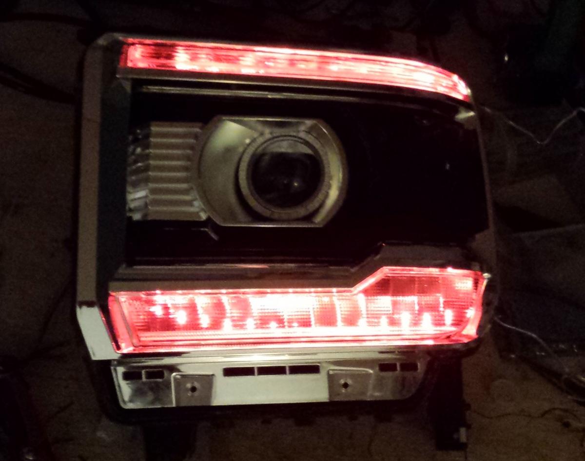

Just noticed he attached pics of customer's lights with email...
Those are my lights lol. For those curious I had an FXR 3.0 retrofit done, oracle colorshift halos, and cleared sidemarkers with LED switchbacks installed. I also got the fog lights outfitted with colorshift halos to match the headlights. I'm expecting them to arrive tomorrow or Monday. I'll post pictures when they are installed.
Do your DRLs also change color? And knowing that you don't seem to be very afraid of opening your housings in every way, did you by any chance try playing with the DRLs to make it so that both LED strips would be on during the day at full brightness? Just curious
He didn't mod them.. FastHeadlights did. That's why he's waiting for them to arrive.
Oh. Psh. I totally knew that.
