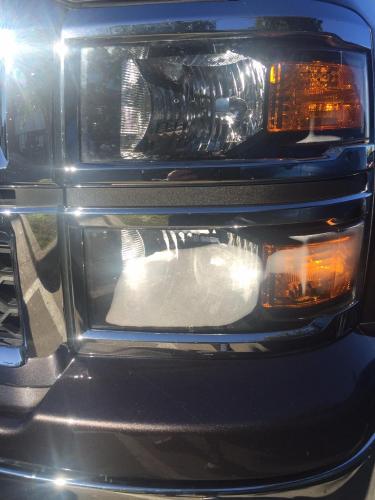

Two questions: Any idea what the causes the three little square above my lights on the wall. Also for adjustment is the cut off correct or can I fine tune that line. Seems to have a lighting bolt type line going on. Thanks
Hey brotha. Just raise up that driver side a hair. I think the little squares are reflection off the oem chrome parts. I have the same on mine.
Thanks bro. I didn't want to bug you on thanksgiving since I'm constantly asking questions. The new lights are so nice. My install looks good too. lol.
