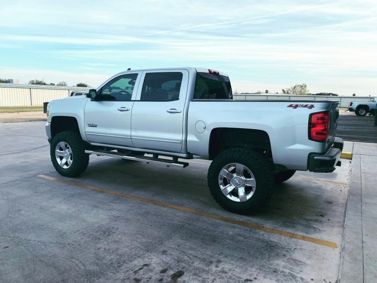

Well I finally pulled the trigger and had my install done after years of reading through this thread. It ended up exactly how I wanted it to thanks to everyone contributing here.
6'' BDS w/ Coil overs
20'' SCA Blackwidow Rims with 0 Offset
Toyo MT 35x12.5x20
1.75 BORA spacer in the rear to match the front without cutting the studs.
Instead of trimming, just took off the lower 1/2 of the valence and used Zone Trim Plates. No rubbing at all or even close now.
It sits perfectly level, just have near 800 lbs of tires/wheels in the bed.
I can finally vouch and say this definitely rides better than stock, even with the MT tires. The coil overs probably make the difference.

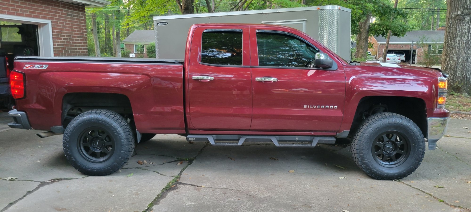

Here is my 2015 Z71 (not the best pic). I'm running the RC 3.5" lift but I added 3" blocks to keep the rake. It has 35-12.5-18's on the stock wheels. I like the setup but I am currently looking into some coilovers. I have not been impressed with the lifted struts. They do not hold up if your running anything extra I.E a Grille Guard, winch. Mine has both and it has caused the springs to settle in the RC struts.
