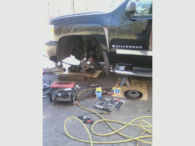

Front end torn down last night
You know you have a bad lower ball joint when...
Gonna rip out all the steering stuff today, flush the old power steering fluid, and reinstall the majority of the front end today. Waiting on new cv axles and upper ball joints. Should drive like a new truck because everything is getting replaced with MOOG and ACDelco parts
Oh man! Did that separate while you were driving? Seen that happen only a handful of times around here.
So sick of front end work - did both at 2 different times. First the lowers & struts, then the uppers & hub bearings.

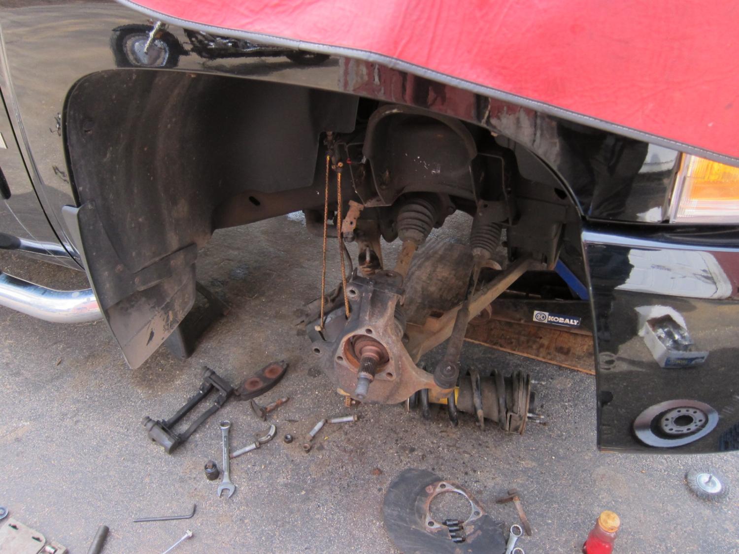

Nah I'm rebuilding the front end. Got the upper seperated from the knuckle then finished pushing the cv axle out and then the knuckle just fell off lol
Everything steering and suspension up front is gone. Power washed frame and all loose parts. Gonna paint anything that needs to be tomorrow as well as flush the power steering fluid and install all the new stuff

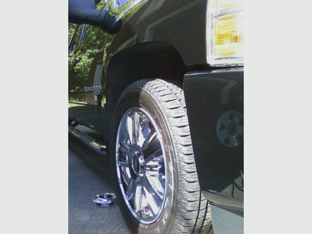

Also got the wheel spacers in. Before:
After:
They are 1.5" wheel spacers. Need them up front bc the wheel offset isn't enough for 13.50's. Not sure how I like them yet...
Makes me wish is gone with remote resi's. Your front frame has better paint than mine too.

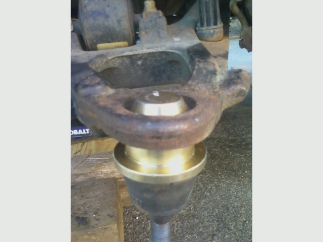

Painted front end of frame today as well as pressed in moog ball joints on all 4 arms. Did adjustable ball joints in the UCA's. Also painted all the control arms
Adjustable ball joints:
Gonna start putting it together tomorrow! Once the suspension is mostly back together, gonna go ahead and replace the tranny with my replacement unit from Performabuilt [emoji3]
Nice - that's the first time I've actually seen a picture of an adjustable one. That gives you some big camber options, looks like.
