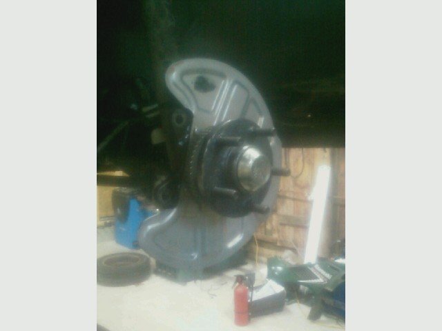

Anyway ... on the shop front, finally got the second OE hub bearing in. Long story short, the company didn't have what I ordered in stock (a cheaper but decent quality bearing), so they offered me ONE OE one for the price of the 2 they couldn't get - that was still almost $50 off the OE price. Had to order a second one from another company - took over 10 days to get here! Volvo had been on the lift for 2 friggin weeks!  I get the part, and UPS had been playing football with the package - knocked the outer race right out of the bearing assembly, and cracked it!  Unreal. It was still  usable with the old race installed.  After that debacle, I decided to go through the whole car and fix everything that was bugging me.

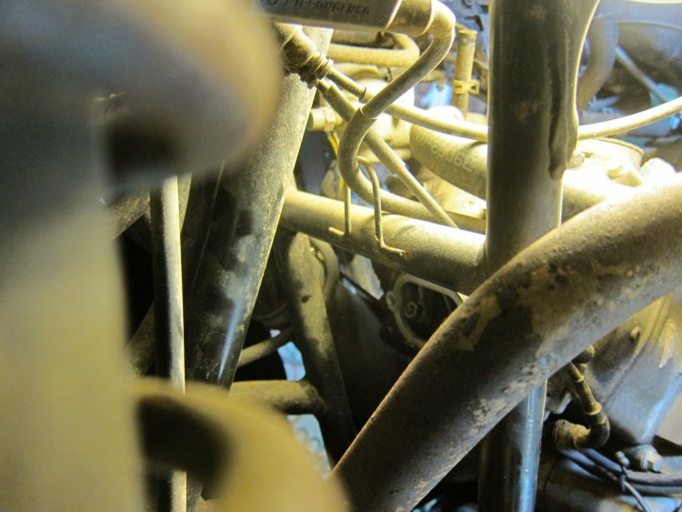

Had a solenoid fail inside the floor shifter mechanism that controls the brake/shift interlock. Got tired of 2 handed shifting (pressing the override, then shifting with the other hand), and rather than spend $50 on a new solenoid and a few hours disassembling the complex mechanism, I heated a screwdriver red hot with the torch, and melted the safety catch. Now that sucker will shift no matter what is happening, LOL. Nice to get in and go. I'll have to train my wife to pull the e-brake any time before she starts the engine. It requires some effort to knock out of park, but it's now possible.
Inspected the brakes, and one of those crap Cardone reman calipers I bought failed on the right rear. The piston is so seized, that when I blocked off the opposing piston, fired up the car, and stomped the pedal to the floor, that frozen piston did not budge 1 millimeter! Never seen a caliper that bad in my entire life!

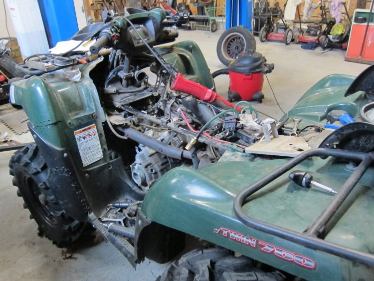

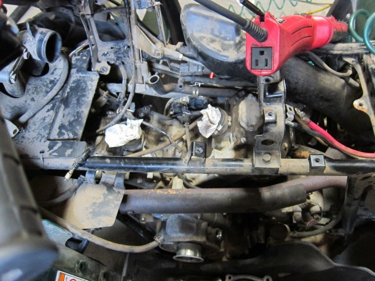

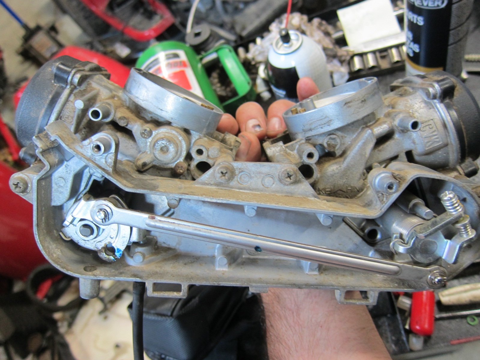

Started tearing down a '06 Kawasaki Brute Force to do a carb clean and valve adjustment. This thing is built like a car - rusty bolts breaking off, speed nuts that had to be cut off, hidden fasteners, and difficult to access areas. Needed to order a clutch puller just to change a belt! Glad I didn't buy one of these back when I was shopping for one. Bought the Sportsman 800 instead in '05, and I still have it.
