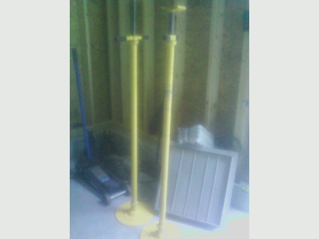

Been busy over here. Bought some more chi-com goods off eBay for the shop. Got a couple high-lift jack stands. Those came in THE WORST packaging I have ever seen in 17 years of internet purchasing. There was just about no paint left on one of them. Missing the roller bearing kit, and the wire locking pin for one of them, too.

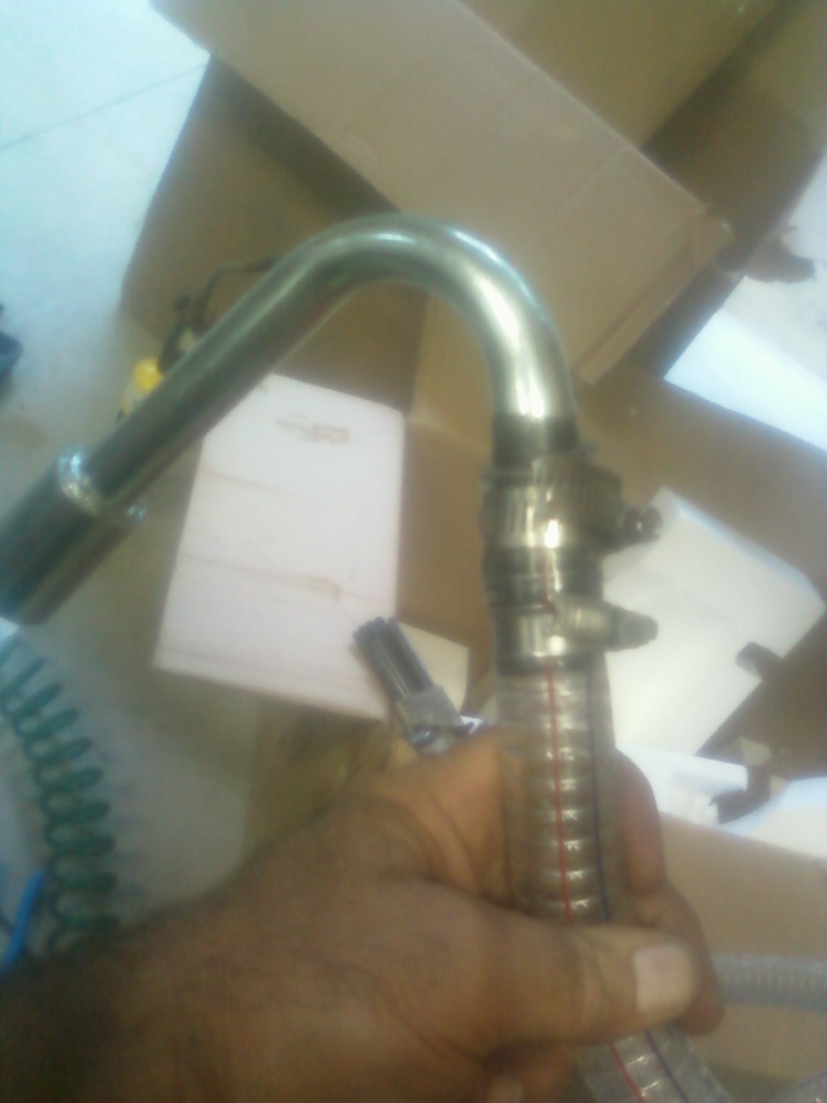

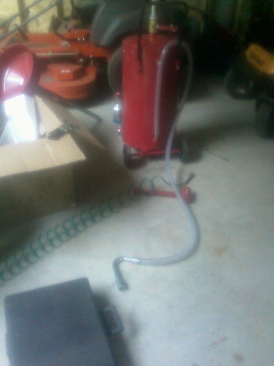

Next up, I unboxed a new 20 gallon extended oil drain for the lift. Uses shop air to empty it through that clear hose when full. I played around with it after I assembled it, and the crimped fitting for the curved metal end slid right off! I tried using my A/C crimpers, but crushed the thing and made it leak 10x worse. Ended up cutting the crimp off and using 2 hose clamps. Never thought I'd see a day in America where you have to constantly fix things right out of the box. What a joke. It's either that, or pay $400+ for a domestic one. This one was $130 to the door. Oh well.

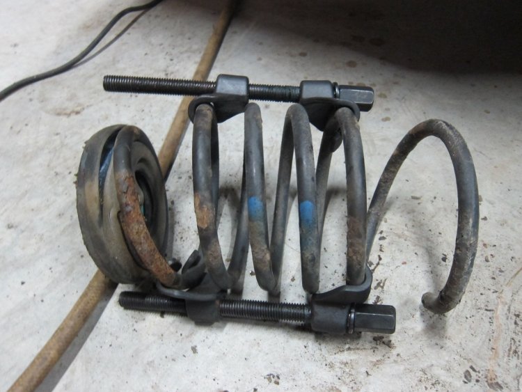

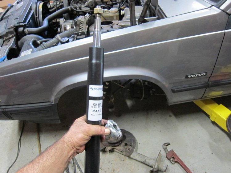

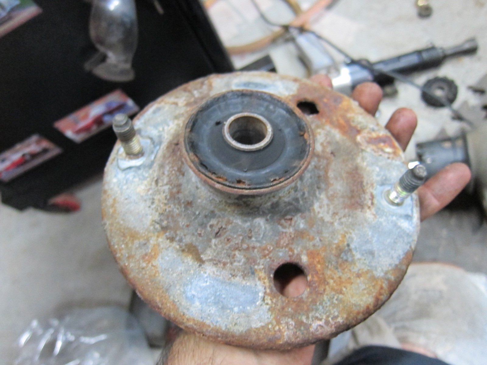

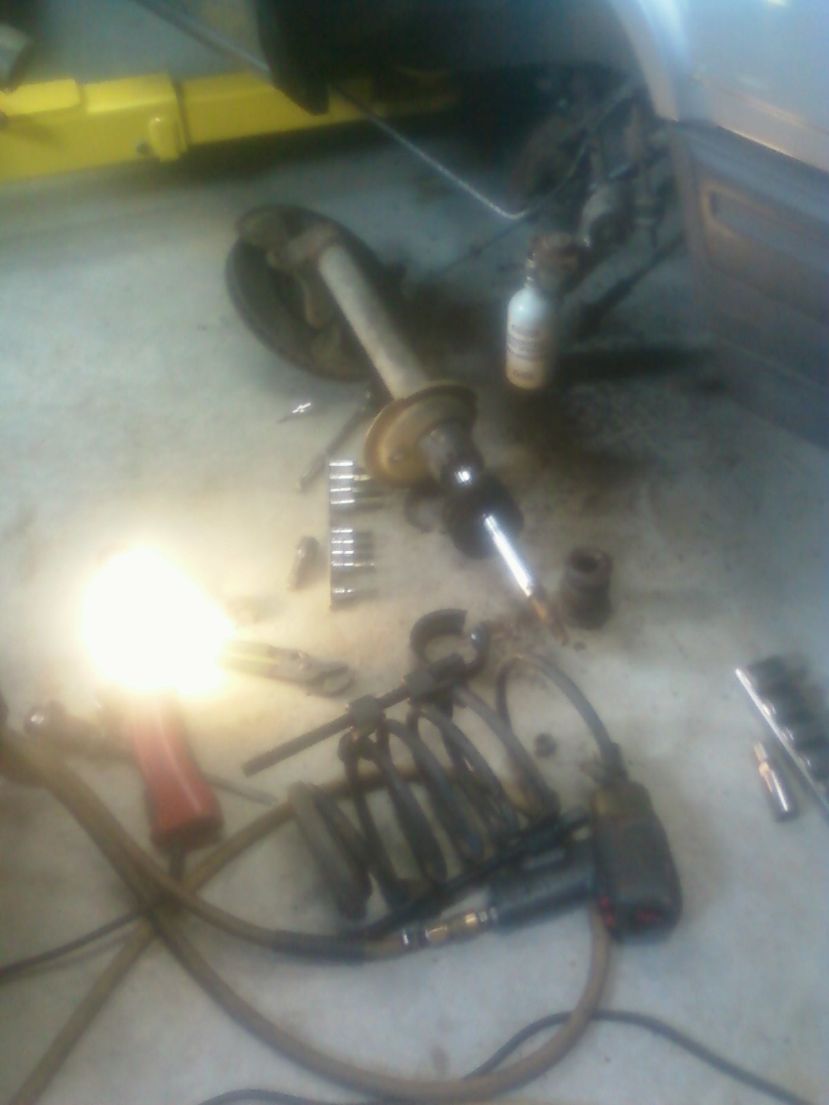

Then, finally started replacing the struts, ball joints, end links (only 2 years old - Advance Auto garbage), hub bearings & backing plates, plus one $100 ABS sensor (frozen solid in place) in the Volvo. I've had the struts, strut bearings, strut bump stops & boots, rear shocks, & motor mounts sitting here in a box for the past 8 months or so. Better late than never I guess ...
GM could learn a thing or 2 from early 90's Volvos. That strut housing attached to the hub is made out of STEEL. I could've sworn it was aluminum due to the lack of rust, and whitish appearance. It's STEEL! Magnet sticks right to it. Now THAT is the metal GM should be using UNDER all their vehicles! Maybe then I could justify the prices they charge. Remember how my lower ball joints failed in the Silverado at 38k miles? Well here's one that failed in the Volvo at 171,672 miles ... only because it had a tear in the boot! The driver's side had ZERO play, and would probably go another 100k.
Some pics are flip-phone, and some are with the good camera. Bet you can't tell which is which, lol ...

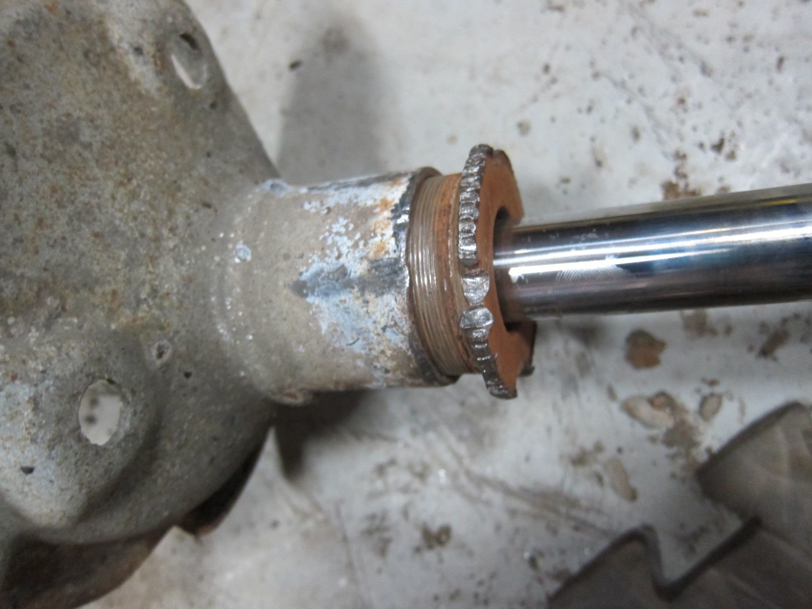

Had a hell of a time getting this retainer out. Made some teeth in it with the monkey wrench, lol
That's supposed to be solid blue all the way around. Sides were wide open to the elements ... and the bearing was STILL usable! Probably been that way 10 years or more.
STEEL that doesn't rust! What a concept! 25 years of New England driving, too. Car started off it's life in NH. Everything here is OE. Remember that when you're replacing your dust shields on the Silverado/Sierra after 9 years ...
