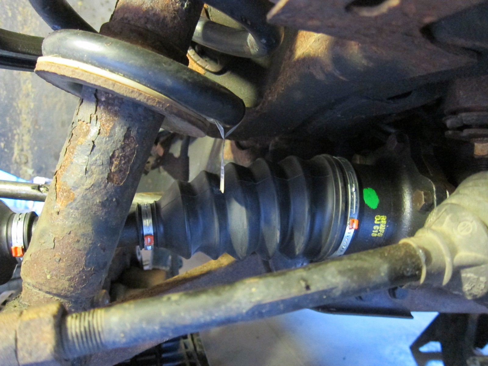

Never a dull moment around here. Truck had the wrong CV axle on one side (for Classic models and backward), so the auto parts store matched up the axles to THAT one, of course, when I sent my wife down there for parts. Installed the ONE they had (figures) while I waited for the delivery of the second one - bolted right up no problem, but was an inch or so too short - didn't catch that at first. While installing the airbag sensors, I noticed the inner boot stretched to the max. Grabbed the shaft, and it moved 5" in every direction - wasn't even splined into the inner joint!! Glad I didn't have the other axle to  test the 4x4 out! Would've ripped the boot in half.
If your inner boot looks like this on a GMT900, you've got the WRONG axle!!
