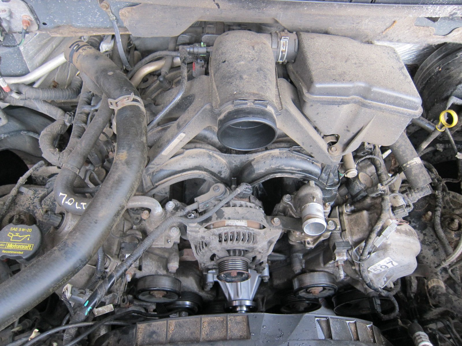

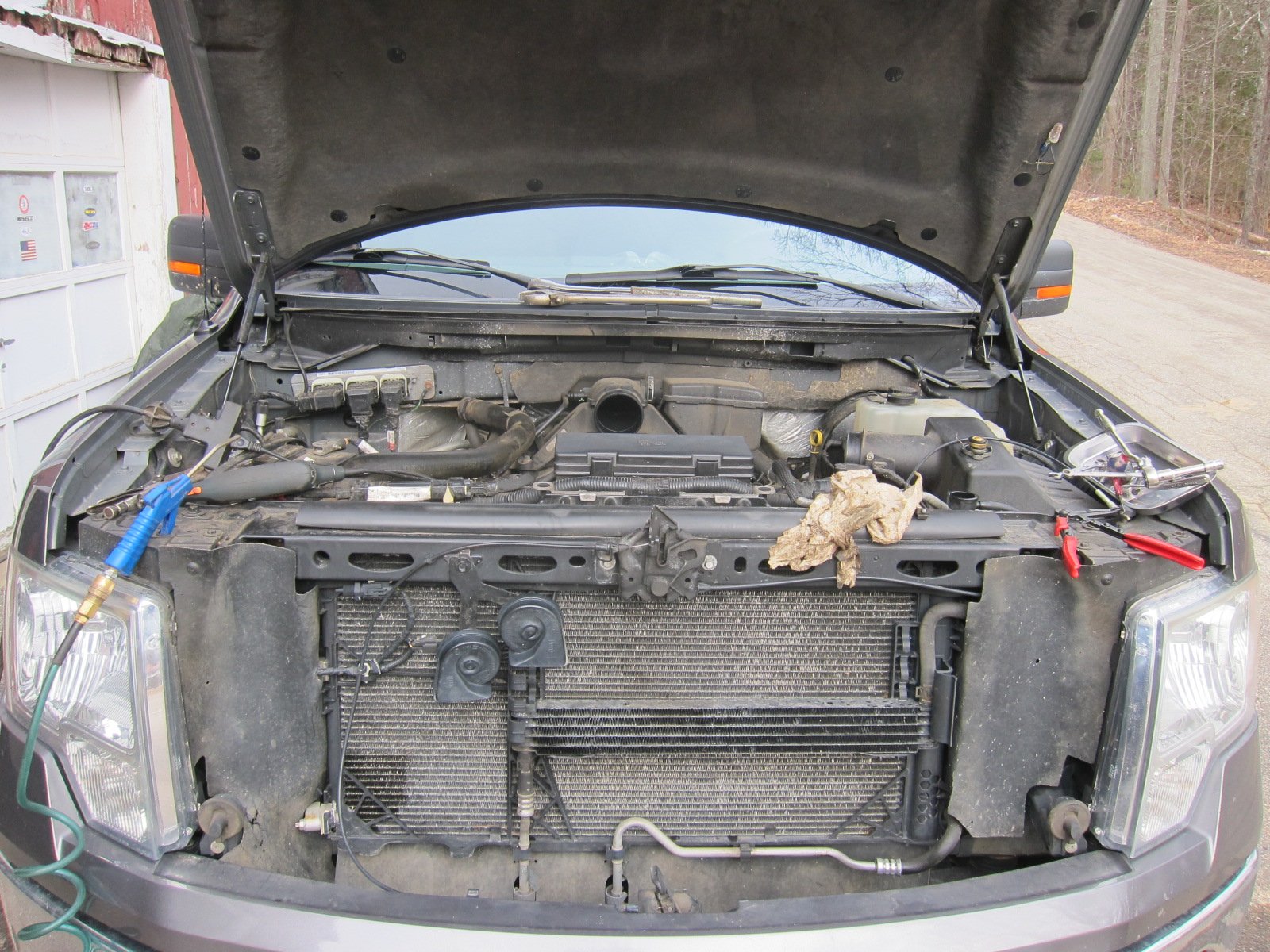

Jsdirt Posted January 18, 2018 Share Posted January 18, 2018 A '09 Ford F-150 came in with a coolant leak. Didn't take long to see the pee stream, which I found coming from the water pump with the best tool ever - a high powered LED flashlight. To be honest, I like FoMoCo's water pump design better than GM's. GM's is MASSIVE, heavy, houses the t-stat, and has the lower hose attached (like they've been since the dawn of time - not a real big deal). Ford one comes off with just 4 bolts, and seals with an o-ring - super easy. Quote Link to comment Share on other sites More sharing options...

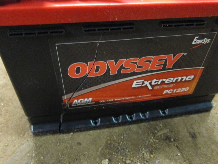

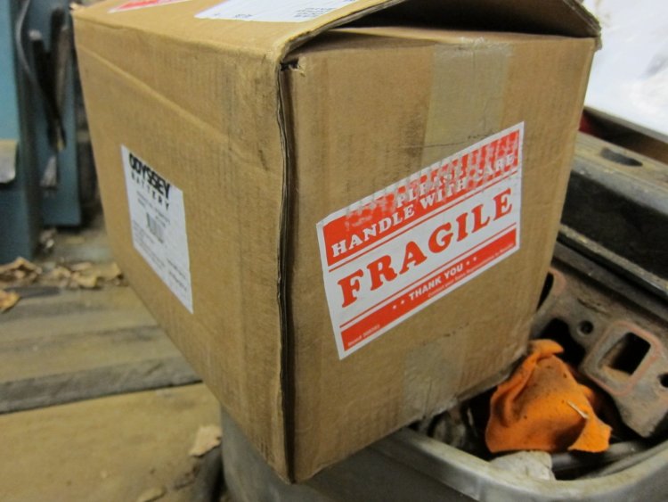

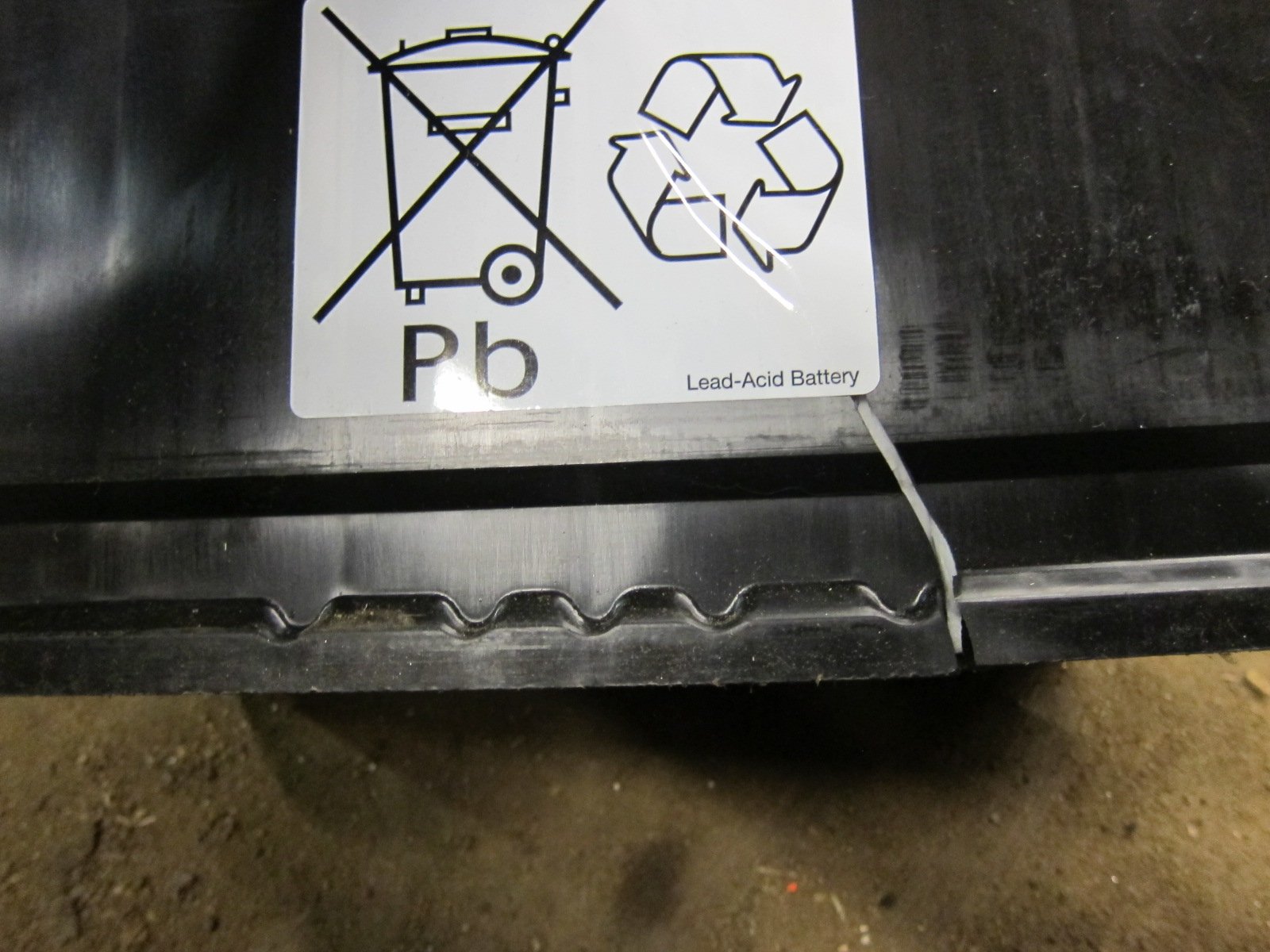

Jsdirt Posted January 19, 2018 Share Posted January 19, 2018 Using that same battery. My first one didn't arrive very well, thanks to UPS ... Quote Link to comment Share on other sites More sharing options...

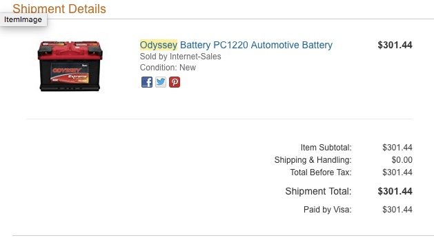

Jsdirt Posted January 19, 2018 Share Posted January 19, 2018 (edited) Wow, you did damn good on that one - I think I paid $310 or something like that (will have to look it up - was a few years back). I think yours has more amperage - typically with Odyssey's, the higher the model number, the larger the battery (Ah). EDIT: Ahh, just found it's 3 years old this month, and a little over $300. You still got a damn good deal there! Edited January 19, 2018 by Jsdirt Quote Link to comment Share on other sites More sharing options...
