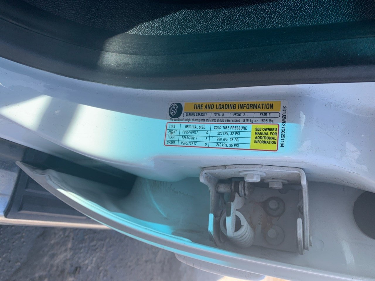

2 hours ago, itsbo1313 said:
Where do I find that on which sticker?
In the door jamb there will be a Tire and Loading Information sticker, white and yellow.  It will list the tire sizes with inflation pressures, seating capacity and the payload capacity.  Subtract that from your 7200 GVWR and you'll know your truck's original curb weight.
This is my Yukon XL's:
14 hours ago, itsbo1313 said:
My NHT also has the different air pressures for the front and rear tires.  Despite the smaller cab, she weighs basically the same as my NHT.  My All-Terrain is about 75 pounds heavier!  All are SLTs so I'm not sure where the extra weight comes from, maybe sound deadening?
