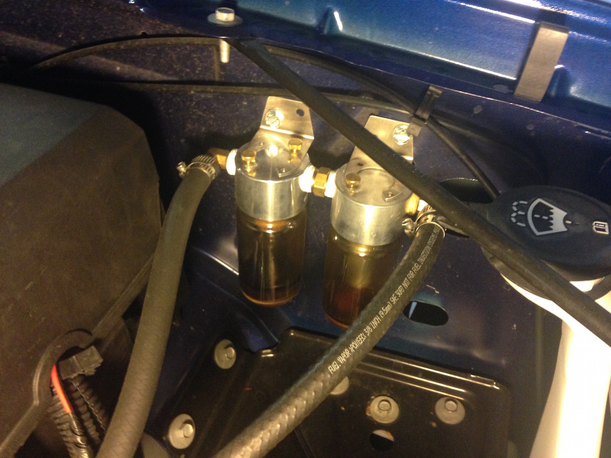

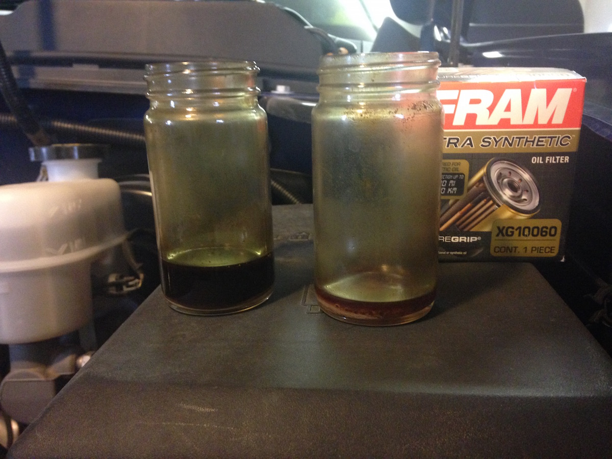

Along with the AFM disable, a PCV oil catch can is almost a must have item to install. It will make you vomit after you see all the junk it catches, that had gone thru to the intake prior to installing one. I capture roughly a full ounce or more of oil, condensation, etc in every 1000 miles. Imagine how much would go thru in 50,000 miles on a engine that didn't have a catch can! That wold be like dumping a couple of quarts of oil into the intake! Is it any wonder why these engines are having issues?
Do you got any pics of the oil catch deal?

I am on the road now, but will post some more pics on my oil catch can setup later.

I use a dual Conceptual Polymer catch can setup. The first, a CP standard filter unit, followed by a CP High Efficiency unit to catch what might have slipped by the first. I capture about 1+ oz of oil, crud, condensation per 1000 miles on average. A little more in winter due to heavier condensation. The oil in the jars shown was from around 300 miles since last dump. I set the jars next to a filter for size perspective. The jars are about 4.5" tall.
Edited by Cowpie
$169.95 shipped, and it connects to the crankcase ventilation pipe in the valve cover, and the other pipe into the intake vacuum source.
Thanks for the info, will need to check it out for sure!
