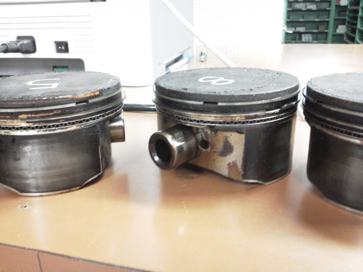

103,976km Add oil warning. GM replaced pistons, rings, spark plugs.
Over 3,000kms so far and not a drop burned. In fact my service guy called to see how it was going so far! Knock on wood, I think this might be it!

Mine is in right now for new pistons and rings. The tech is doing the job with the block still in the truck. I'll report when I get her back. 54K on the ODO.
Kxlexus, if you have the time would you mind posting the parts they replaced like gaskets, rings, pistons, etc, and I'll do the same when I get my Sierra back. We'll compare notes and see if the dealers do the job the same. Thanks.
