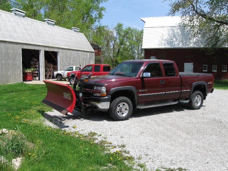

the 8.1 is a little bit heaver but not un manageable mine has a 6.0 ,is it a crew cab ? it will add more weight to the front end .typically you need a 4800 lb front gross Axel weight rating for snow plows or suspension aid's .here's mine " i dont have the 4800 lb frt end ,only about three crank's on the bar's and about 6 sand bag's .
