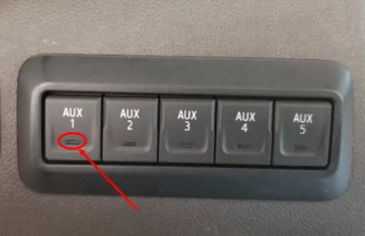

Auxiliary Switch LED Problems – The Issue
According to a recent GM TechLink article, the LED “on” indicators on the upfitter auxiliary switches (RPO 9L7) may not illuminate as they should. Specifically, if you have only one auxiliary switch turned on, the LED indicator will light up just fine. But if you decide to go switch-happy and turn on more than one, the LED indicators go dark.
Auxiliary Switch LED Problems – What’s Not Affected
Before you start thinking it’s time to replace some components or auxiliary equipment, hold your horses!  The switches themselves are working perfectly fine; it’s just the “on” indicators that are acting up. So, your auxiliary equipment will still operate as expected.
Fix: Auxiliary Switches May Not Illuminate Properly on 2023/2024 Silverado & Sierra Image Courtesy GM Techlink
Auxiliary Switch LED Problems – The Fix
Now, let’s get to the good stuff—the solution. If you find that your auxiliary switches are not illuminating correctly, the fix is to reprogram the Body Control Module (BCM) with the latest calibrations. This is a task best left to the professionals, so head on over to your nearest GM service center for a quick fix.
