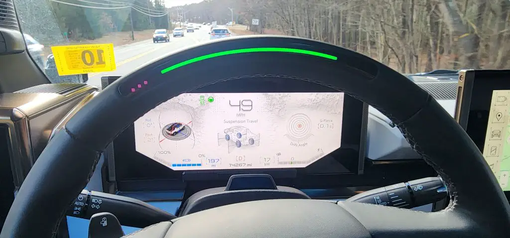

Recently, our GMC HUMMER EV would not allow us to use Super Cruise on roads we knew were mapped and included as part of the Super Cruise Road network. Roads we had used Super Cruise before on suddenly gave us an error message when trying to engage the system. “Super Cruise Unavalaible- No Road Information.” We knew that couldn’t be right- as we had used the system on the same roads before- sometimes the day before.
Even more frustratingly, the error message was inconsistent- sometimes appearing when driving east- but the system would engage and work normally while driving west. Or, the error message would appear one day and not the next.

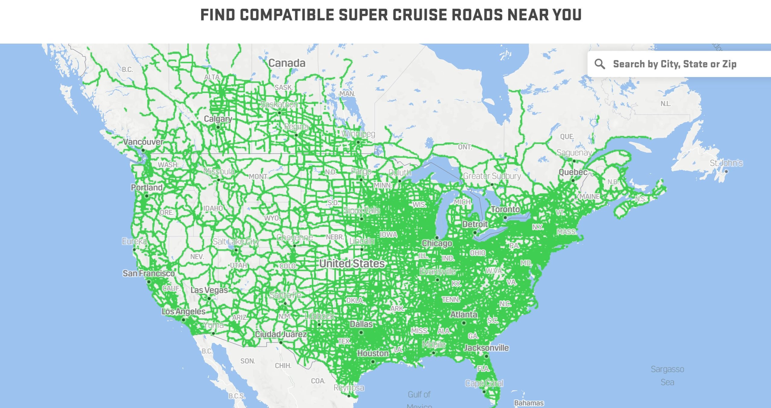

The problem is that Super Cruise doesn’t work on every road. For a driver to enable Super Cruise, the road must first be mapped by GM. The process involves using high-accuracy GPS measurements, LiDAR scanning of the road surface, and camera mapping of speed limits and road curves. That data is combined into information that is uploaded into Super Cruise enabled vehicles and allows them to engage the system on only those roads that have been processed by GM. The company currently has 400,000 miles of Super Cruise enabled roads and plans to double the amount in 2024. The data required to store that information is a unique module inside the vehicle dedicated to Super Cruise Maping.
The Solution for “Super Cruise Unavailable – No Road Info”
GM has identified that the problem lies with either out-of-date software inside that Super Cruise Map Module or bad hardware inside the module.
However, the best first step is to confirm that the road you’re attempting to use Super Cruise on is actually listed as a Super Cruise-compatible road.
