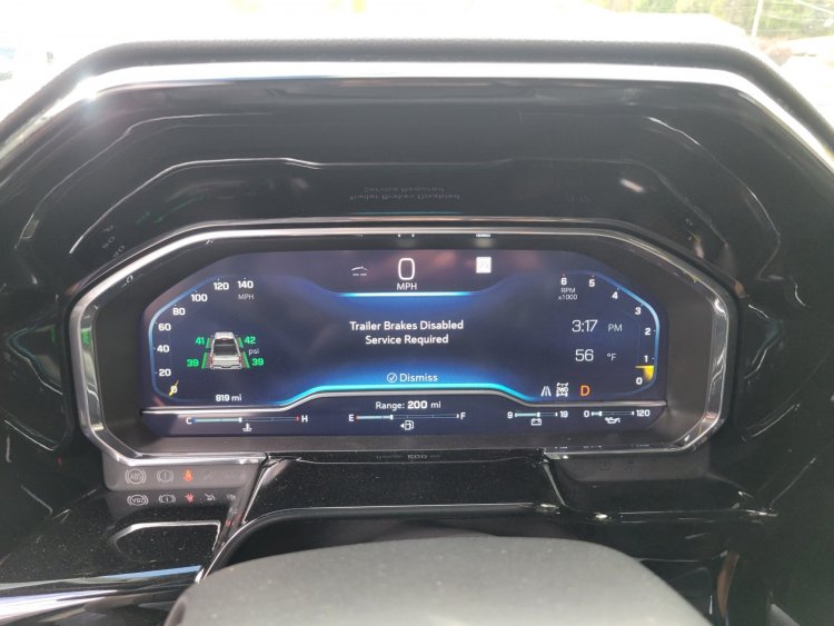

I'm having the exact same issue sans the camera issue.  Same technical bulletin given to me by the dealer and C159C code. My dealer gave me the information, I called GM to ensure I opened a case - I bought my 2022 refresh 3.0 RST to tow a small camper for my family and I.
The brakes work fine for a few minutes - then they throw a message onto my info panel "Trailer Brakes Disabled Service Required".
I thought it was my trailer, however had my neighbors tow it with their Ram and Ford, neither had any issue.
I called my dealer, they informed me it could be the technical bulletin/code above, but to bring it in - they confirmed my truck was falling under it.
They did wire an aftermarket controller into it on Friday, which I will test this afternoon (was running around all weekend with kids and events). I also called customer service this AM to get a case number (albeit they cannot find the technical bulletin on their side) - but the most frustrating part of this the lack of transparency and estimated timeline to fix.
I found this truck in transit to my dealer because it had the package with the brake controller and cameras in the mirrors that will shoot back either side when the turn signal is on, my wife booked a few camp sites for us this fall (including this coming weekend) - if the external controller doesn't work, we will need to cancel those, and regardless, the brake controller with wires up to my center console is not going to be an acceptable long-term solution.
I wish:
1) I was told about this during my purchase - I doubt my salesman knew of the issue - I put my wife, myself, and other motorists in danger by driving he rest of the way home from the trailer dealership, but took it easy, however when I did need to stop - the brake smell was obvious.
2) I could find more transparency online regarding the PIT5948A/C159C online, this is one of the only places I could find a post on it.
If this external brake controller doesn't work, I'll video the issue in my driveway and post on YouTube to show you the issues I'm having.
edit/update - The external brake controller did not work.  I've photo the message I receive when trying to use the integrated controller.
Edited by brentrb031
update/photo

No, I have not, but my trailer brakes worked perfectly with the aftermarket brake controller (Primus IQ 90160) installed on my previous vehicle.
I'm dropping my truck off at dealer overnight, they are going to try another external brake controller and this time test it on an employee's trailer.
This all sucks b/c 1) they are 45 minutes away. 2) I don't have the time to take it during the day b/c of meetings and 3) I need to find rides home tonight and there tomorrow night - I leave for a work trip on Wednesday AM, returning Friday afternoon before our scheduled trip.  I guess I'll need to test it Tuesday night before I leave to determine if we can even go on our trip at this point.
